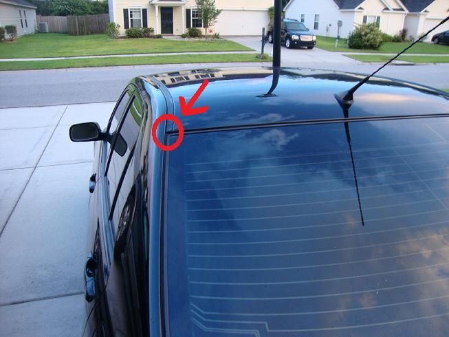

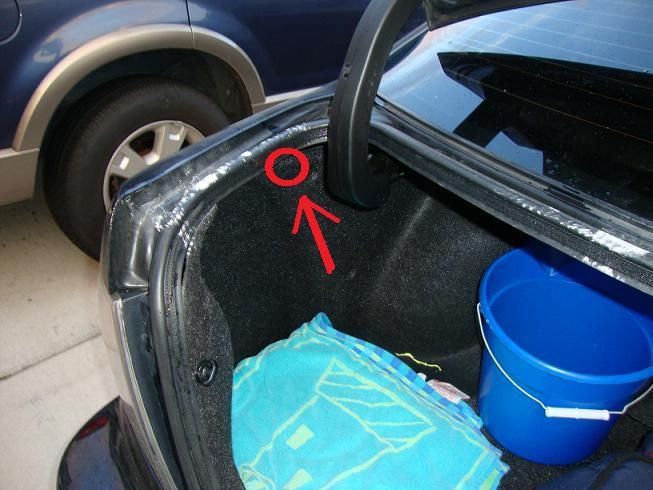

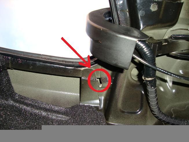

Does anyone know if there is a drain line behind the glass running along the rear pillar where it's circles at in the 1st picture? The right side actually drains down to the rear bumper and onto the ground like it's supposed to. The drivers side just drips into the trunk where it is circled in the 2nd picture. 3rd picture just shows the location of the 2nd picture. The sunroof drains down below the front doors so they're no clogged. What can I do to get this fixed?...other than some clear silicone to clog the hole, not wanting to "rig" it up. Here are the pix.....

Yes, there is the same size gap on the other size...how can I clear the line with air?..i see where the 2 holes are on the sunroof. Those are both clear and drains properly. How do you get to the ones on the back glass?..can you just blow air in the gap between the seal and roof?

I got the same problem too. I got leaks from the part u circled in the trunk. Hope you found where it coming from so I can fix it too. =(

yeah, it's not leaking inside the cabin..just into the trunk where the 2nd picture is circled. there's a tiny, tiny gap..but it's the same size gap on the Pass. side...but on the drivers side leaks into the trunk. Maybe a small dab of clear silicone in the hole will close the hole...I'd rather get it fixed instead of fix-it repaired. I know a shop will prob charge alot. How hard would it be to pull the rear window seal and install a new one? Or does the rear window have to be removed in order to do this?

Ops I meant back window haha. So to fix this problem I Ned to go to a local window replacement company and replace the seal? What if only the driver side only tho?
#13 ·
I went to a body shop and was told its a common problem for the is300's. The rear window seal will start to leak after a couple of years and needs to be replaced. I get water on the right and left sides and need to pull my drainplugs after EVERY rain or wash. What a pain in the ass. Poor design or material on the window gasket! You want it to stop replace your window gasket.
#16 ·
Researched more should I try some windshield sealant on it? Some people say the sealant stopped the leak and if it don't then I guess u Ned a new mold. Think it's a good idea to try it first?

I'm not the only one... I haven't been able to leave a damn thing in the trunk since I bought this thing used a year ago. This is how I found out...
Here's a pic I took, jamming my cell camera up in the trunk hoping to get a better look.
One of the windshield guys at the last dealer I worked at said he could reseal and reuse the glass for $80; but I had no idea there were drain tubes back there! I caught the leak coming in and took some pics, but I never saw the tubes.
