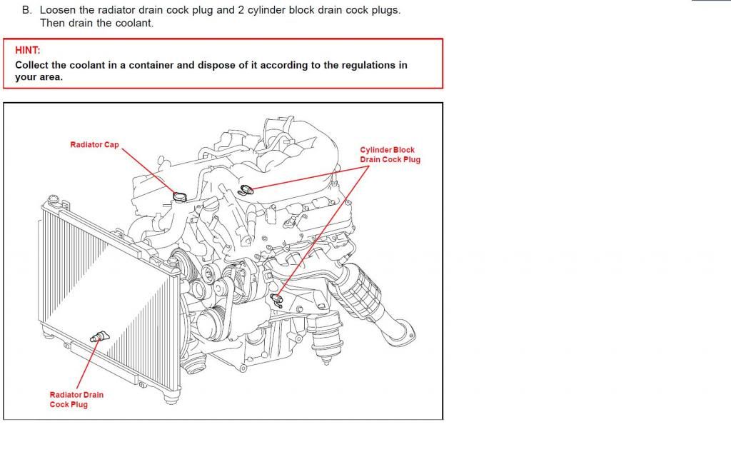

Basically there are two drain plugs to drain the cylinder blocks of coolant; one on each side of the engine. I found an unrelated TSB which had a drain and fill as one of the steps. Luckilly it displayed a detailed picture of the location of the plugs.

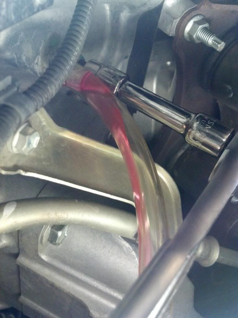

The passenger side was very easy to locate as it was directly under the header/exhaust manifold. I attached a 3/8" piece of tubing from the drain to run the coolant down to my bucket.

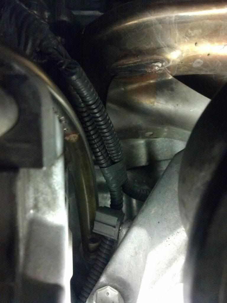

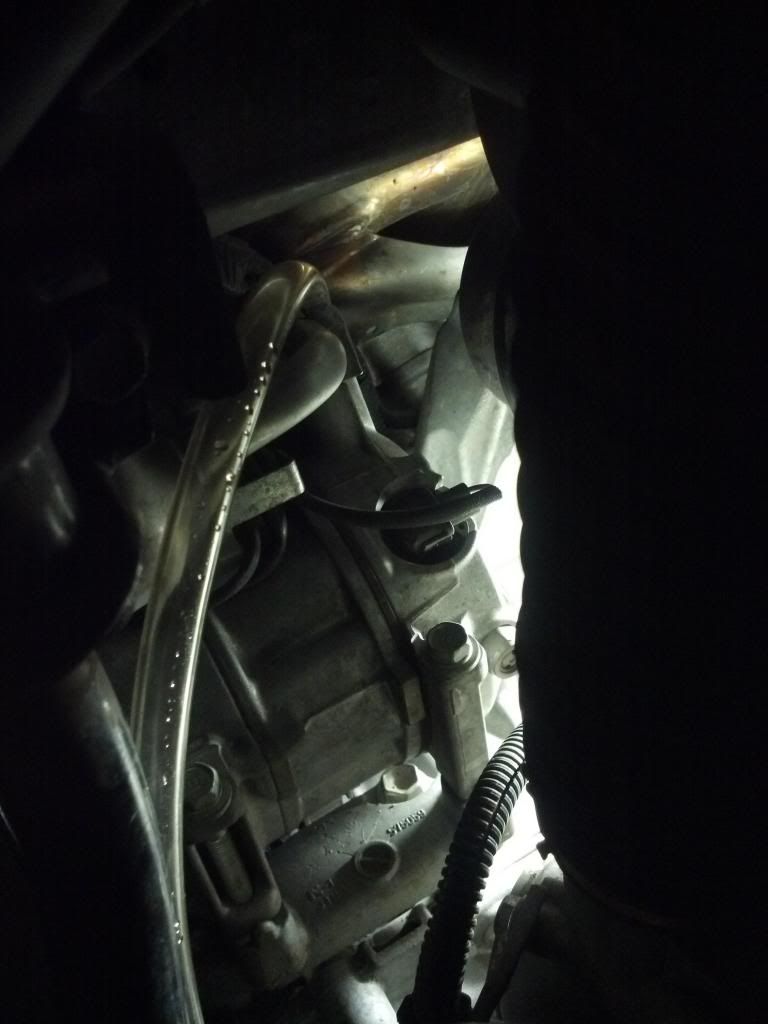

As for the drivers side, it took me while to find the plug. I tried my best to take the pic to show the location but it was tight in there. It was just above where the motor mount attaches to the engine, hidden behind a loom of wires.
