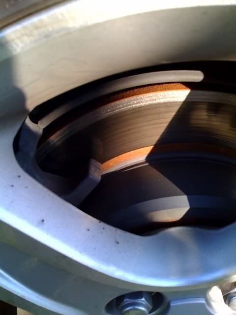

It doesnt happen all the time, but its gotten worse lately, sounds horrrrrible while driving, I'm down to just driving back n forth to work, but I know its going to be costly :-(
But can someone please explain to me what happen? none of the other ones are like it....
heres a picture of the good one:
and here's what the bad one looks like:

Dude, why would you even drive on that? Now instead of spending a few bucks on new pads you will have to replace the rotors too :pissed:
I did the rear ones on mine last week and it took longer to jack up the car and remove the wheel than to replace the pads.

Your rear pads are shot. Your rear rotor needs to be changed as well since it has had metal on metal contact.

for my defense, my girlfriend drove the car for 3 days before she told me about this, we switch every couple days between the is300 and the gsxr600..
sigh.. new rotors.. damn.
ah, just noticed I had the picture titles backwards. will fix.
Do you recommend me changing just this one? both on the back? or all 4?

Are the front ones metal on metal too, or is it just the rear one?

My rear pad started scraping last week without any warning. Tell you the truth it looked a bit like yours, maybe not as deep. I got new pads and so far so good, given my rotor was not that damaged. Most of the time you can get away with it since the rear ones don't do as much work as the front.
