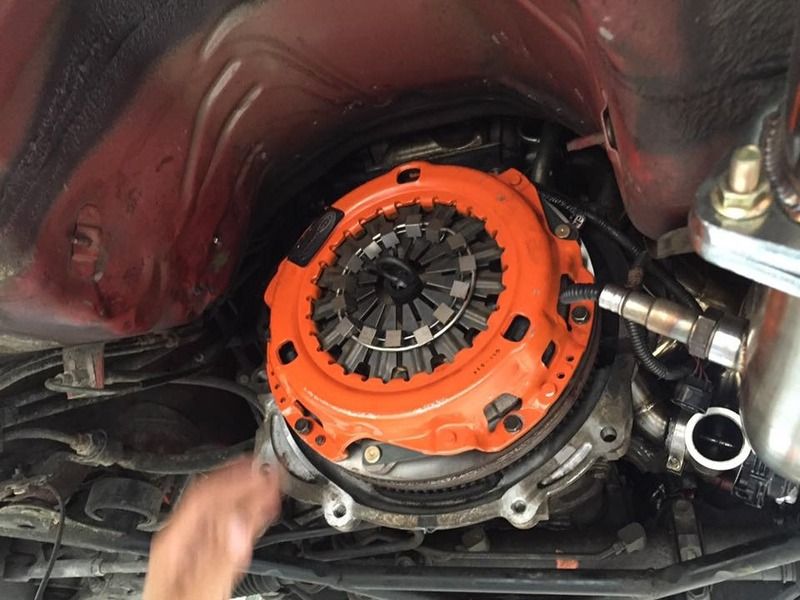

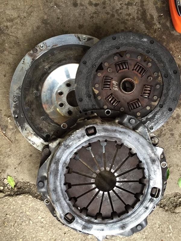

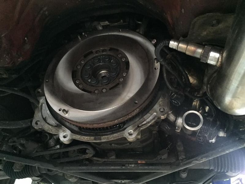

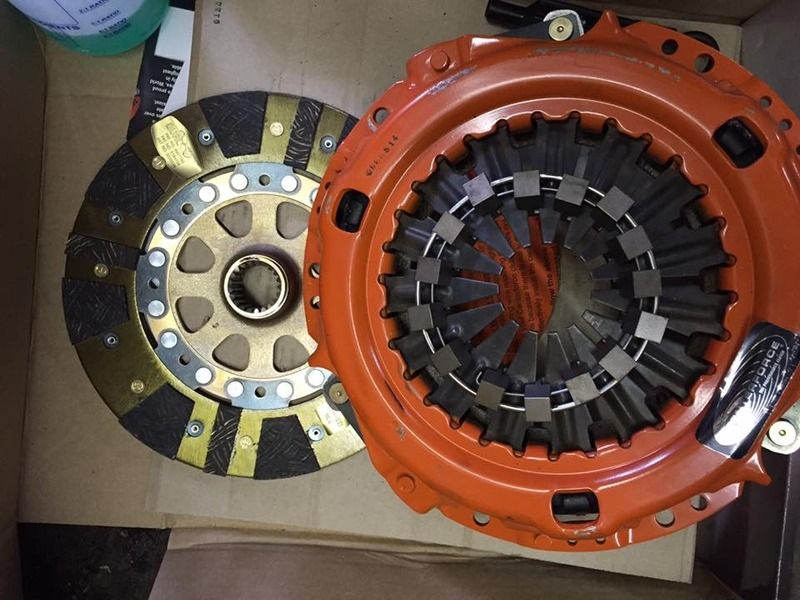

Replaced the clutch this week. Ive been taking my sweet time, but hey, I'm in no rush.

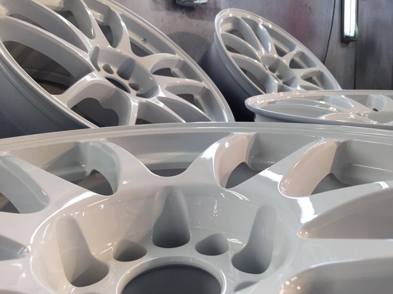

I went ahead and took out the old light weight flywheel and replaced it with the stock dual mass flywheel and Centerforce clutch kit. Call me crazy for going backwards but I had a terrible experience with my last Is300 lightweight flywheel and aggressive clutch set up. If I have any issues in the future ill go back to the lightweight flywheel. Also a sneek peek at the new wheels!
