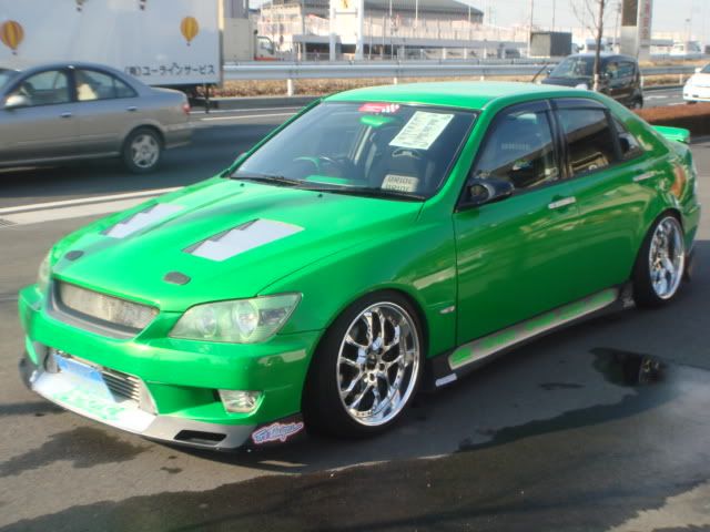

Too bad Ryan lexus84 repainted his car green and already named his the incredible hulk!?
Considering that this car has been in the making for almost THREE years now and had the green paint for a little over two years and was at SEMA last year with the paint job already done I would say the originality goes to him.
