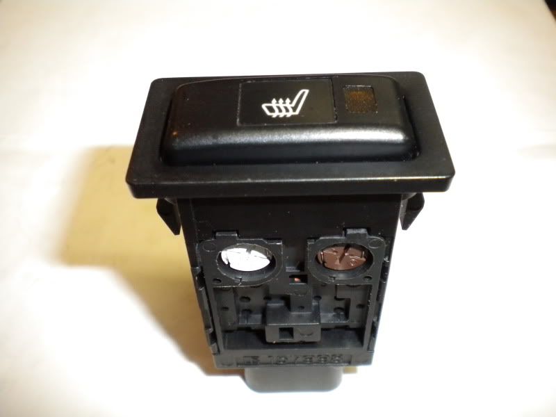

Just wanted to post a helpful thread on the seat heater switch lights for Canadian members.
I always have trouble finding a good thread on this.
The brown base light is a brighter watt light that controls the "ON" light - CDN Part 84999-10310 and is 6.20 each
The white base light is a lesser watt light that stay lit as your panel lights do - CDN Part 90011-01016 and is $6.60 each

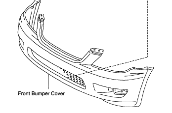

...also the body clips that hold on your grille (4 of them) are
CDN Part 52117-53010 - $3.90 each

Are those body clips something the dealer would keep in stock? Or would they need to order them?

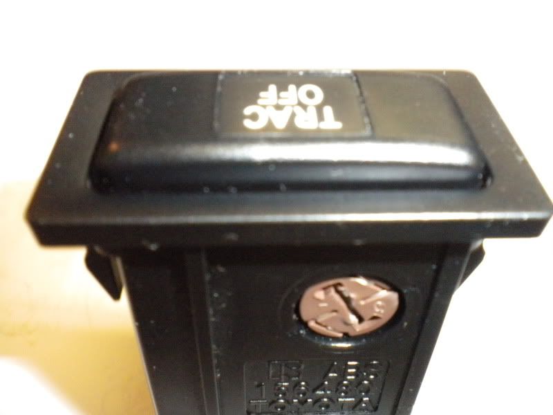

I was able to source the correct bulb for the trac switch.
Toyota part number 83119-24670 - $3.30
It is a green base bulb/ not brown based as I have pictured.
It is 1.12 watts

Finally replaced these bulbs! All the part numbers indicated in this thread are correct for US too, but I think the OP may have gotten the part numbers for the seat warmer switch mixed up.
The bulb with the white base is indeed the bulb for the part of the button that stays lit when the lights are on. However the part number is 84999 - 10310
The brown base is the bulb for the part of the button that illuminates when the warmer is turned on and the correct part number is 90011-01016
The TRAC button is correctly indicated as 83119 - 24670

All my bulbs in this trac/snow/seat heater cluster are OK except 1 of them...the convenience light for one of the seat heaters (p/n 84999 - 10310 white base) that lights up when the dash lights are on. The other indicator bulbs that indicate when the seat heater is actually pushed on (p/n 90011-01016 brown base) are OK.
It was very hard to see the broken filament on the 84999 - 10310 white base bulb...i needed a magnifying glass. Interestingly, the other bulbs were fine BUT all convenience lights are not lighting up in the snow/trac/seat heater cluster...which means i believe these bulbs are wired in series (i.e. if 1 bulb burns out, nothing lights up). I will continue the hunt for this 84999 - 10310 bulb.

I successfully got 2 of the 84999 - 10310 white base bulbs and installed them one-by-one and they work!...my theory is not correct, they are not wired in series. I guess all my bulb filaments actually died at the same time that one time a few years ago (how they died simultaneously is anyone's guess...I must buy a lottery ticket).
The remaining bulb I need to get is the TRAC/Snow button bulb which I believe is different from the singular TRAC OFF button light in this thread. My TRACOFF/Snow button has a bulb with a philips screw head black base.
