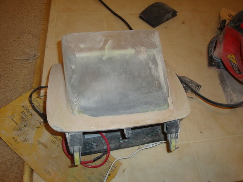

Work in process random pic:
This pic basically reflects all the main components of the unit, brains and screen.
Hi everyone. I built a couple plug and play carpcs for the IS300 and I was wondering if there would be any interest in these units if I started producing them for is300 members.
Installing these units simply involves taking the stock HU out and plugging the IS-PC in. I will be using the stock HU PCB board and case. IT WILL RETAIN STOCK SOUND SYSTEM FUNCTIONALITY. Capabilities include: FULL TOUCHSCREEN, MP3 player, Movie player, HD radio, GPS, HDTV, OBD reader, engine tunning, etc (some of these are options). It has the capabilities of a regular PC.
Thank you all.

I built it myself. Epoxy, sanding and paint. Oh and almost forgot, one unit has already been built and shipped to a .netter before this thread was started.
