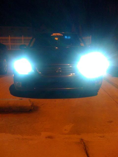

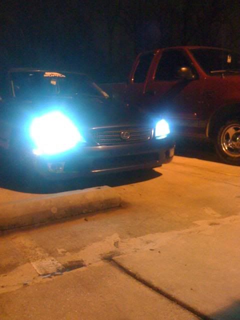

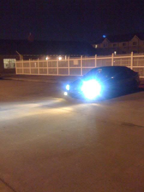

So today my new HID bulbs came in and after "fairly" easy install (though the lack of space can be frustrating) I like the results of the 10000k bulbs...though i might just drop down to 6000k since its the brightest light..i know wasting money :jawDrop:
might just use the 10000k to convert my High beams to HID since Mf'ers around here like to flash their lights at people for no apparent reason...so i might as well blind them suckers.
New lower control arm bushings will be pressed in and installed on car by the end of the week...(decided against new control arms)
The IS might start looking good again after all :cool:
Pictures:
622 Posts
Well I knew 10000k weren't the brightest, but I like the color (though people say blue is so 90s...hahaha)
Either way I will find a use for them even if I do order the 6000k eventually

Actually, the brightest bulb is our stock bulb (4300K) because it puts out the most lumens. Philips just came out with a new bulb called "Crystal Vision" and it's 5000K (85122CX) for D2R & D2S. Then there's the Ultinon 6000K (85122WX) and the PIAA Super Cobalt 6600K. I can get a killer deal from a rep I know at PIAA.

Oh really? I never knew 4300k was actually the brightest...but then again most sites only list 6k thru 25000k and say that the 6k is the brightest...guess that means out of those.
Either way my 10000k's are already growing on me...now for HID Halo's and Brights maybe? or is that just wasting money?

I've been going to HID Retrofit Parts Projectors Ballasts D2S Bulbs and they have a wealth of information. Especialy the forum HID Planet University. The higher you go up in the kevin scale, the less intensity and illumination. Don't get me wrong, the higher K values are cool looking if that is your goal they're just not the sharpest. I actually like the Ultinon 6000K and I am well aware of what I'm giving up. Best wishes nonetheless.

As for lights, I know the higher the number you are just burning off light and losing brightness, but for now the 10000k has my vote...but i could change them anyway lol
