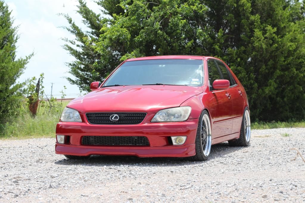

Well, I've had my IS for a while now and I finished the swap maybe around a year and a half ago but I wasn't really happy enough to post it. It's to a point now where I can be proud to do so, so I am! :)
Everything had been in the works for quite some time. I had a really nice 95 Honda Civic hatch that I kitted out really nicely - 5 lug, LS swap, turbo, nice interior, nice exterior, partially shaved and fully tucked engine bay, it was the tits if you're into that sort of thing. But.. I was at a point in the build where it either needed more power (it was making 283 to the wheels on a stock longblock) by building the engine and moving to e85 and making about 400whp, or selling the car to partially fund the IS300 build. I think you can guess what ended up happening...
While I still had the Civic I picked up an IS300. It had about 160k miles on it, I didn't really care about the mileage, and I slowly started thinking about all of the parts I would need to get this bad boy swapped. Luckily for me a dear dear friend of mine, Matt, also known as DedicatedMatt did this swap for the first time when we were roommates actually, so I had an awesome resource for help when I needed. Being the badass he is he hooked me up with mounts, headers, oil pan, clutch line kit, drive shaft, solid diff bushings, moral support, and telling me what I needed to do on the wiring. My friend Richard did the bodywork for me, and my dad being the nice guy he is offered to paint it for me. The paint did turn out pretty good too, its not perfect but it's WAY better than it was. I had the car so long it was looking beat from the outside and now it pops quite nicely I think! Gotta thank my boss Tony for letting me keep it at the shop and the guys working that ever had to push it because it was a non running POS lol. Thanks for the support from all my friends and anyone that think it's cool too =D
Here's some pics!!
[URL=http://s137.photobucket.com/user/kuja396/media/My%20IS300/IMG_3045_zps97b0d054.jpg.html]
I think this is most of the parts on the car right now. More things are planned in the future. (I'll explain later)
