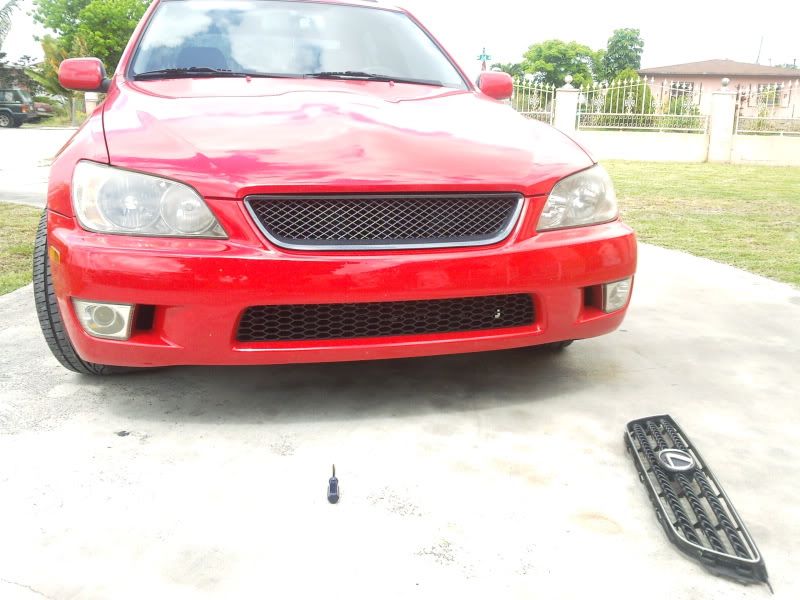

Here it is all buttoned up
And the results
Viva la difference!
(New - Sportsdesign on top, Old - Stock underneath)

I know I'm bumping up an old thread, but anyway...
I just changed my stock grille to the SD grille, but in doing so, I learned I am missing two plastic screws, and one is busted. I'm also missing the center screw! :pissed:
Is there somewhere I could get replacements for these? Dealership, hardware store?

Hey, I had the same problem. I had two plastic screws that were broken, I asked my friend who works at Toyota to help me find some of thsoe rivet type things and he just gave them to me. Im sure it won't cost you that much, and the screw is also very standard, you don't need anything special.
