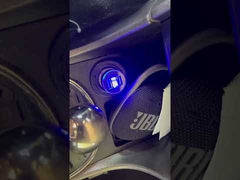

I've recently been experiencing an electrical problem with my 01 Is300. I was having a problem with it my IS not charging my batteries so I replaced my alternator / battery with no sucess. I've went through through everything and checked my terminals and battery terminals to find that my 120A alternator fuse ended up being burnt. The fuse itself was fine but the actual connector of it was burned and the plastic around it was melted.
I tried to remedy this by relocating (?) the fuse outside of the fuse box with a new fuse. I essentially took the two terminals that supply power to the 120A and moved it outside the fuse box in hopes I'd get it running enough to at least get it to a shop. The car now has the issue that it will not crank at all or even attempt to and when attempting to crank it all I lose power to all the center console, all the dash lights stay on.
I already know this was a beyond butchered attempt at fixing the issue and I should've probably towed it to a shop from the beginning but I'm struggling to even find an entire fuse box with a wiring loom for sale anywhere. Does anyone have any ideas or any shop suggestions that could potentially help remedy this? I'm in the ATL area.
Here is a video rundown of the issue.
