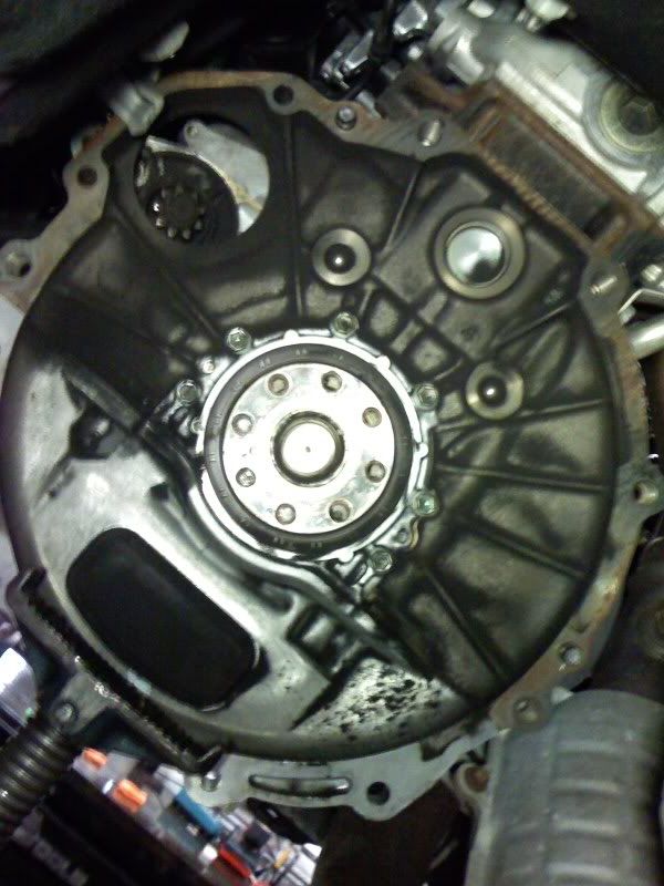

flywheel removed, thank god the thing was dry as a bone cuz i wasn't planning on doing a rear main also

1,575 Posts
Did you find out what was leaking in the bell housing before you reassembled?
6 Posts
i didn't have anything leaking. did i state that i did? must have misunderstood.

1,575 Posts
OK, but looking at the "clutch and plate removed" picture there was some thing that was "thrown" out onto the flywheel surface and the bell housing doesn't look too clean either. And there was definite contamination on the contact surface. But hey, it's cool with me.
19 Posts
the clamping force claims to be 70% over stock
oh! all that stuff are heat spot marks, they are all over the place. the thing is trashed.
