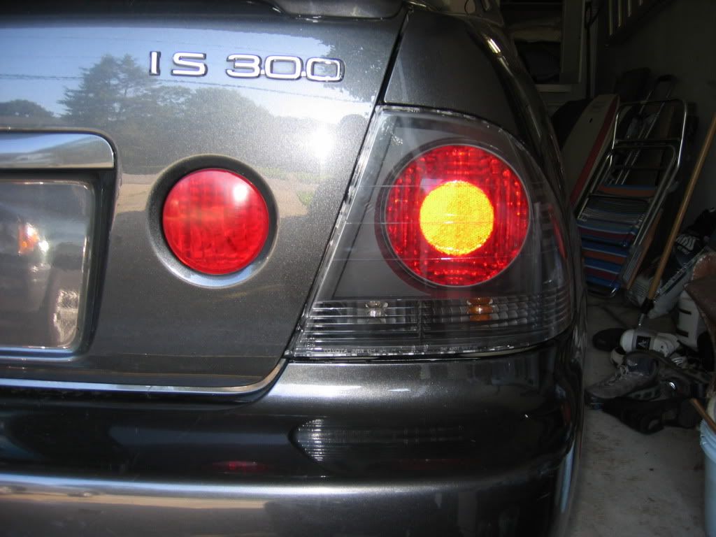

**The only problem I encountered is that after resealing the lens, there is a small white border left around the taillight because the cross section of the lens turns an opaque white after being cut. I thought that the black silicone I used would show through it and it would be black but it did not. It's not that noticeable but I am going to eventually paint over it to fix it and post pics and edit this post. But for now, here's how I did it:

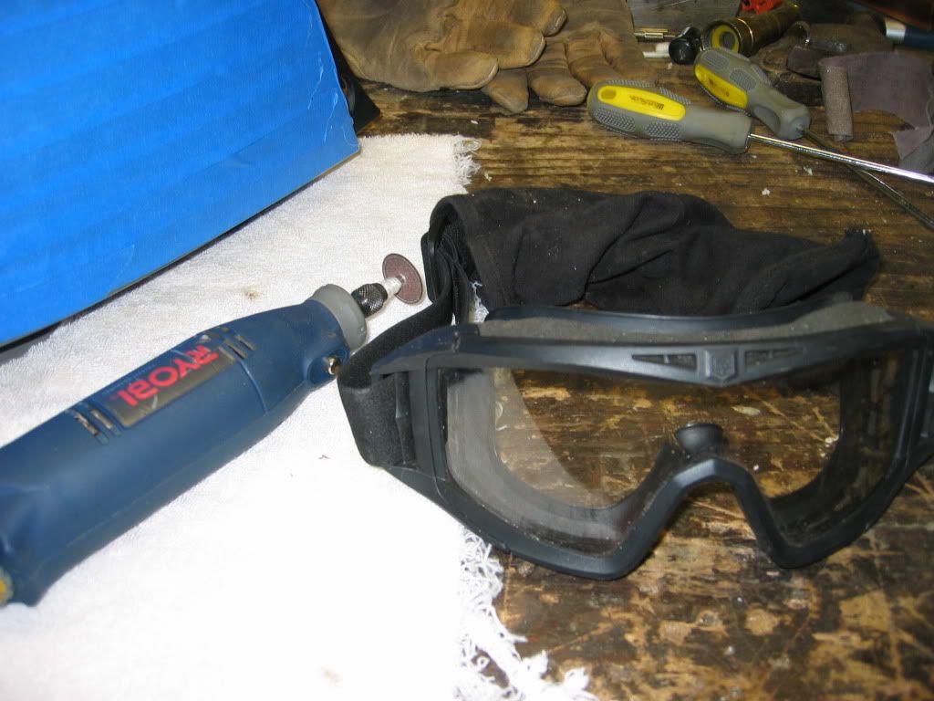

Dremel and goggles:

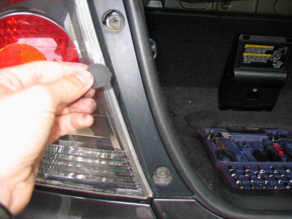

Open your trunk. Notice the two black tabs the trunk was hiding that are along the black border of the light.
Take out the two black tabs to the right of the light using a small flathead screwdriver. Don't be afraid to pry them out, they're just tabs.

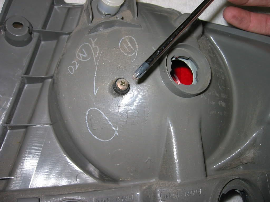

On the right tail light, there is an extra wire connection with a Phillips head screw holding it in. You need to unscrew that along with the other light bulbs to free it up and get it out. Here it is pictured here on the left:

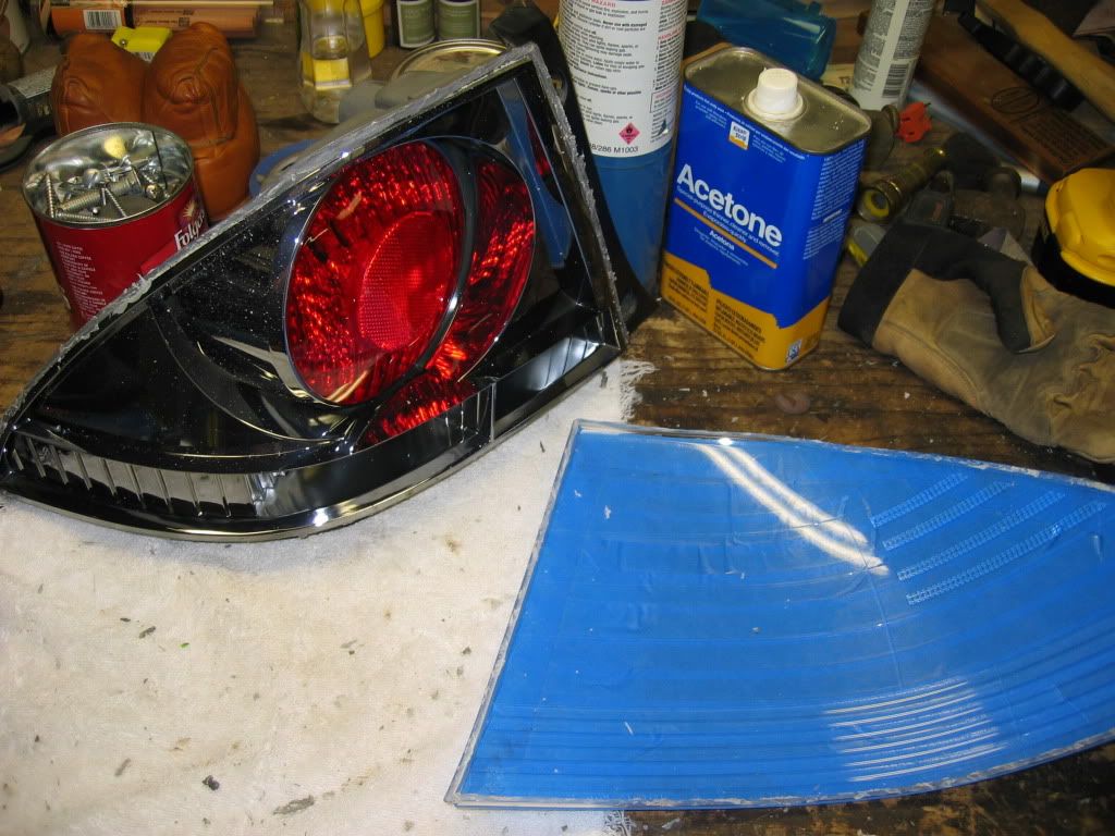

3) Prepping the lens for cutting.

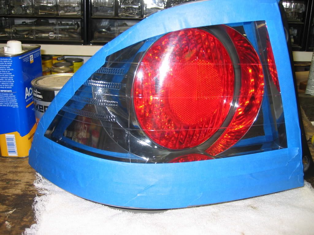

Use the painters tape to tape up the lens completely. This will prevent damage during the process.

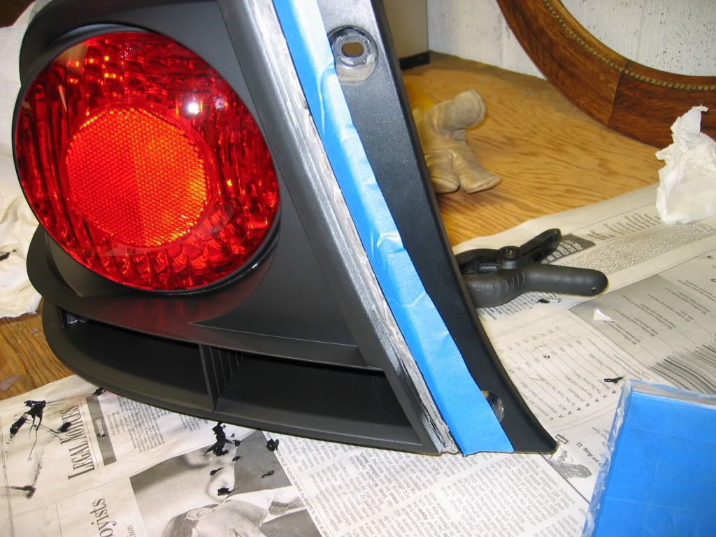

4) Cutting the lens

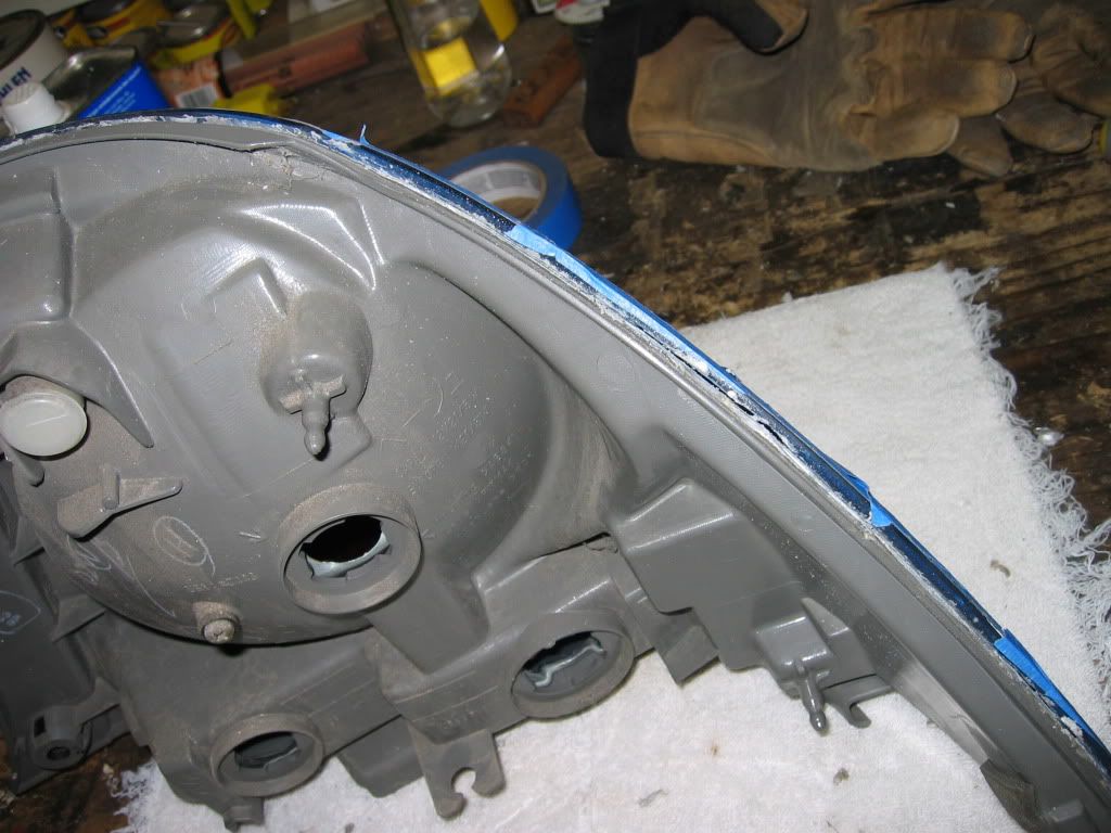

Get your dremel ready, and position the light. Make the incision along the gray part/lens border. It looks like this as you're doing it:
Be CAREFUL. Be PATIENT.
Cut it all the way around.

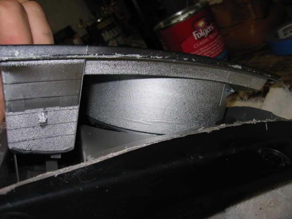

Once you have finished cutting, the lens comes off. Make sure the lens is cut all the way through on all sides. If done properly, the lens comes right off very easily. No need to force it off. Forcing it runs the risk of cracking it.
5) Getting the chrome housing out.
Once the lens is off, you can remove the chrome housing from the grey housing. There is a single Phillips head screw with a white plastic washer and a black rubber washer on it. Remove it and don't lose the washers.

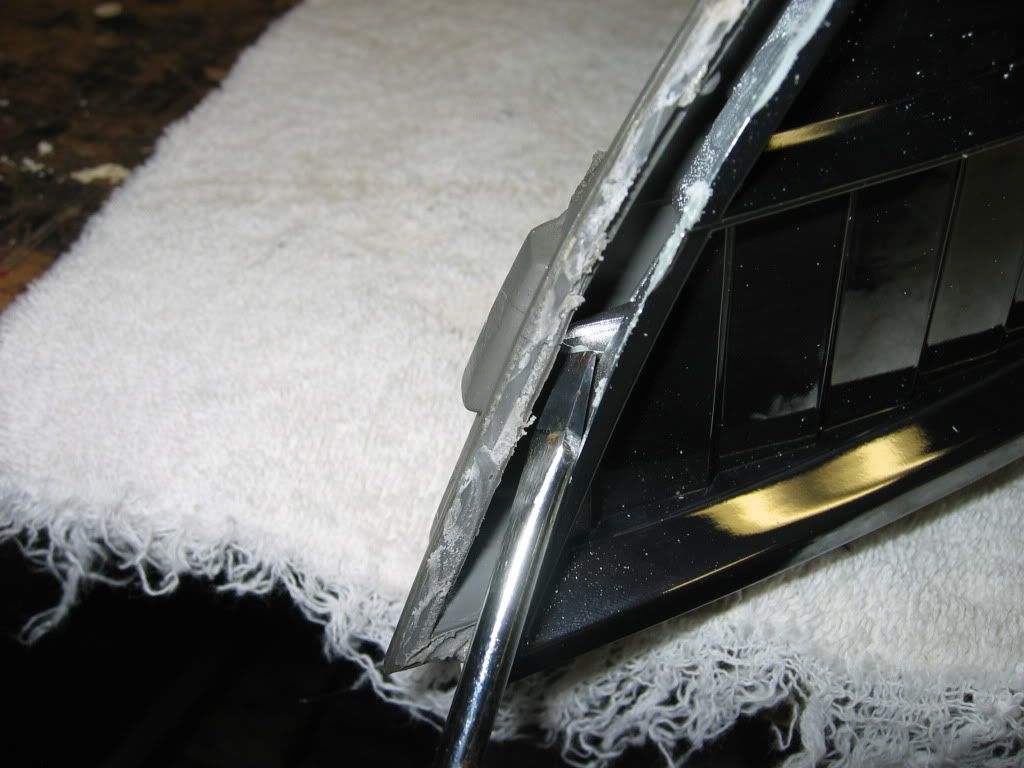

The chrome housing took a little persuasion to come off. I used a Flathead to levy it up on all sides a little at a time. There is a tab on the non-black corner of the light that needs to come out. Use the screwdriver to levy it up and out of its tab.
There are also two tabs on the black border side of the light pictured here:

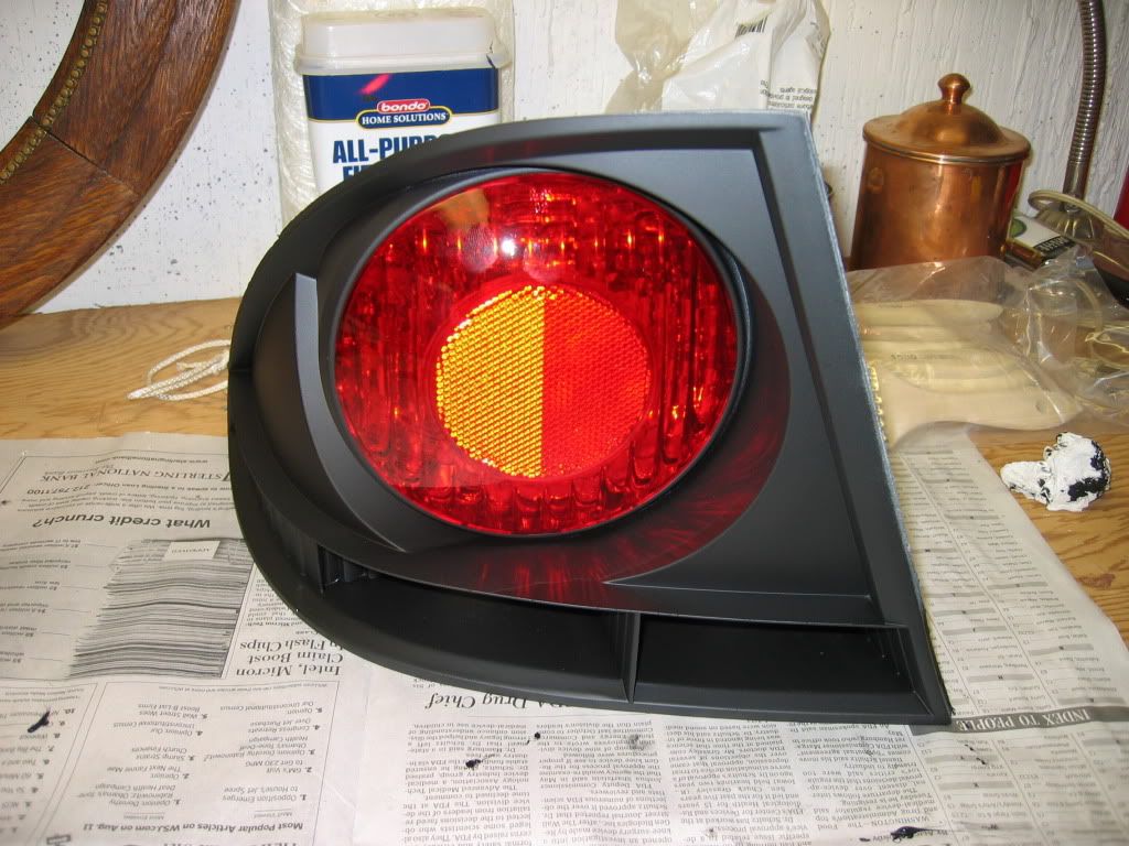

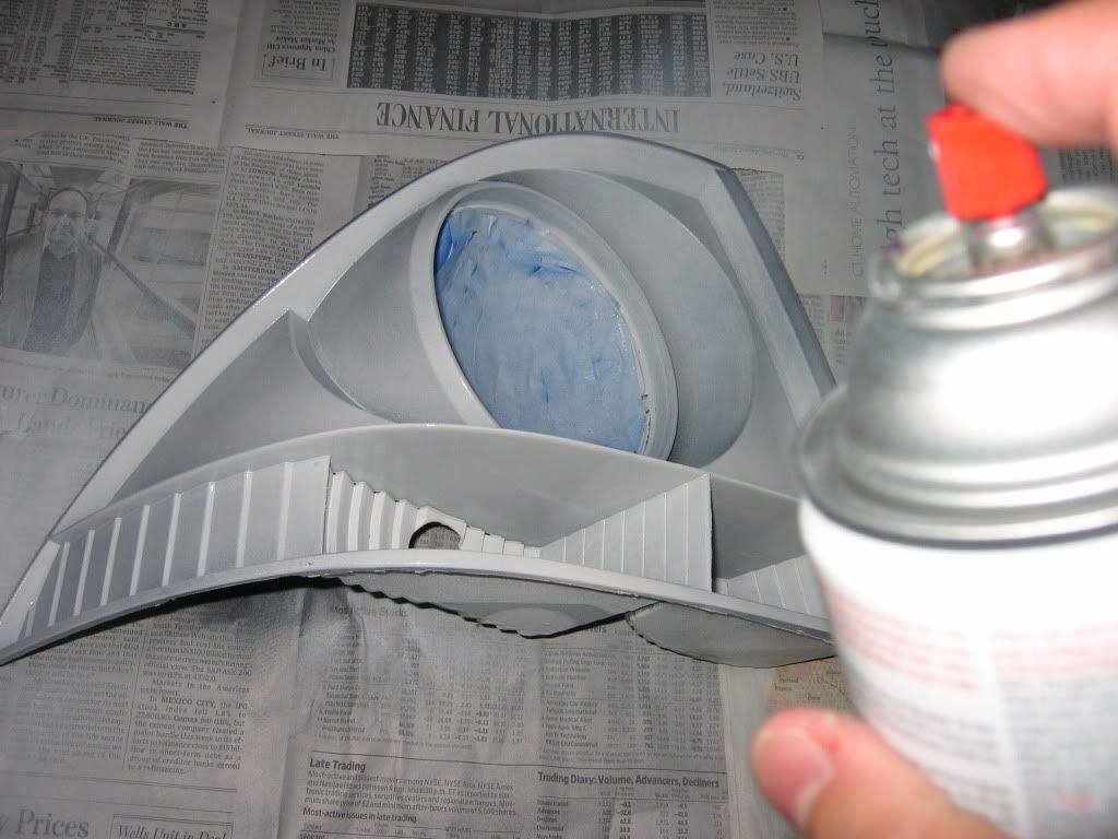

7) Priming and painting.
I used paint designed for plastic for this purpose. If you'd like to use high heat paint, you can. I did not, as the regular paint should be fine. Wash the housing with soap and water. This gets the debris off and gets it clean. DRY it thoroughly afterward. Now find a place to paint and lay down the primer coat. Do NOT use heavy coats. Do small light passes until it is fully covered. Using light coats is key. Primer:
When that's done, let it dry for at least an hour or two. Then you're ready to paint the color coat. I used light passes to fully cover the housing from all angles. Since it's an odd shape with nooks and crannies you need to come in from many different angles. Make sure it's fully covered, but do NOT use heavy passes. Keep it light. I used two coats to make sure the color really stuck on there (waiting 10 mins between coats).
Once it's dry, remove your tape and stick the red lens back in (it pops back in):
Starting to look badass already!

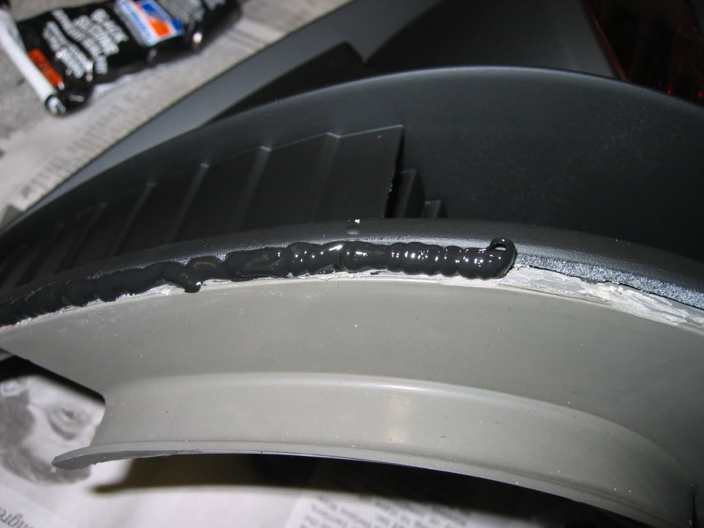

9) Sealing it back up.
Put some latex gloves on if you can because the silicone is some gross stuff.
Apply a nice bead along gray housing edges. Be generous (but not too generous). It should feel like decorating a cupcake with that colorful icing, except in a "making your car more badass" way.
Once the silicone is on and you're ready to set the lens down on it, be careful. Set it down correctly the first time. You don't want to pull it back apart and reset it down.
Now grab the clamps and clamp down the corners and edges best you can.
Once that's done, let it set for as long as you can. 24hrs is good. Once it sets, cut the excess off with an exacto knife.
NOW YOU'RE DONE! Enjoy!
(Notice the white border....yeah I'm working on fixing that)
