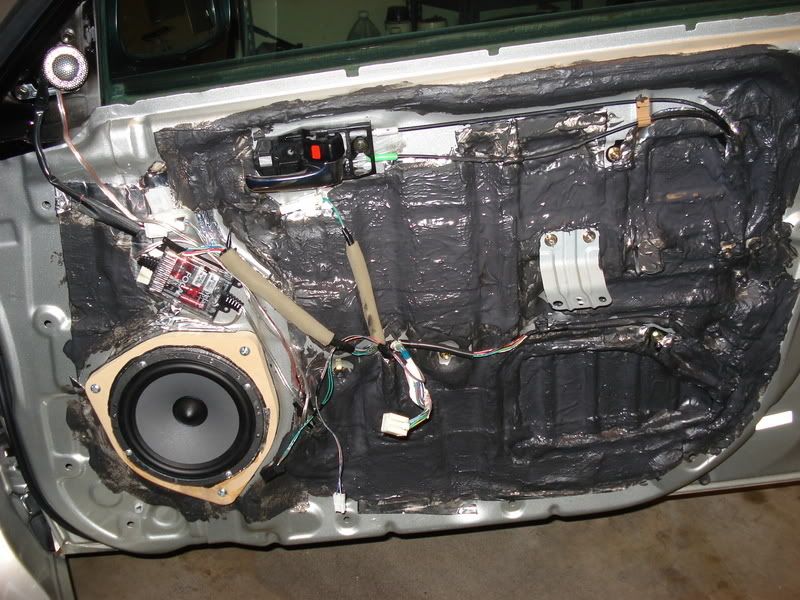

Here is a picture of my door deadened and sealed with Damplifier and liquid Spectrum. It is important to note that there are some holes you shouldn’t cover such as the holes the door panel snaps into and small drain holes on the very bottom of the door. When it rains the drain holes are necessary to keep water from pooling in the door. Other than that cover all you can! You can deaden right over wires, this doesn’t harm them and actually works as a way to secure them and keeps them from rattling. Be sure to keep the harnesses that plug into the door free to move since you will need to plug those back in and put the panel back on.

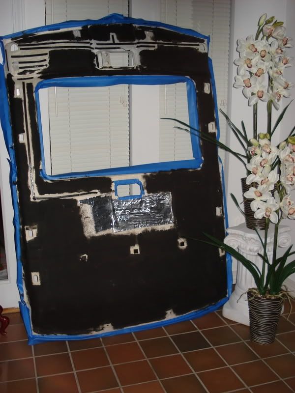

Headliner with Spectrum

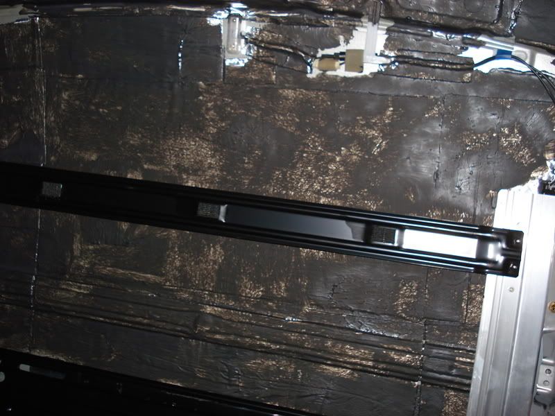

The next most important place to deaden is under the spare tire. The basin the tire sits in is a single sheet of thin metal that has holes in it fitted with plastic plugs you can pull out if water gets in your trunk. This area is incredibly noisy when driving. Go for a drive with the trunk stripped and the rear seats out and you will think you have all the doors open there is so much road noise. The backseat pads and trunk carpet help with the noise but they can only do so much. I deadened right over the drain plugs and over everything in the trunk. The result was very nice. Deadening the trunk and the trunk lid will kill a ton of rattles (since in all likelihood your sub will reside there) and it will also direct more bass into the cabin since it will not escape through the trunk.

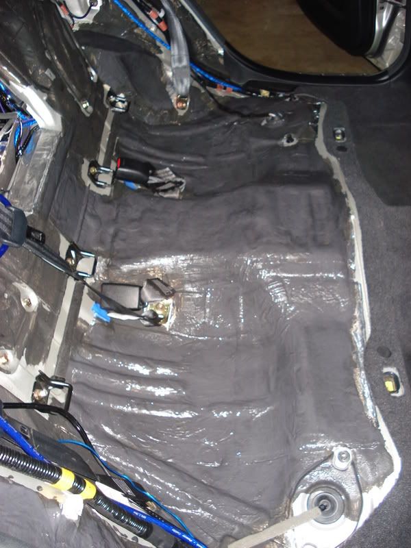

Rear Seat Area
The last part of the car that I think really needs to be deadened is the rear seat area. The rear seat area consists of the metal that divides the trunk and the cabin, under the rear seat bottom, and the rear deck. The rear seats help insulate noise from the rear wheel wells and they also kill exhaust noise. The rear deck needs to be deadened only because it rattles….thats it
I did Damplifier and Spectrum on the rear seat bottom and the trunks metal divider. I think this helped a lot with the road noise as well.

Stylion - How did you apply the Spectrum (paint brush, spackle knife, etc)? When you did the roof was there any drippage? Thanks again for all the great info!
Actually, i used different things depending on where I was applying it. On flat surfaces I used one of those small roller brushes, that covered a lot of area and never allowed it to get too thick to run. I used that on the ceiling as well as other flat areas. I used brushes on the other areas that were more convoluted.
Spectrum is fairly thick though so you can get a good coat before it starts to run.
