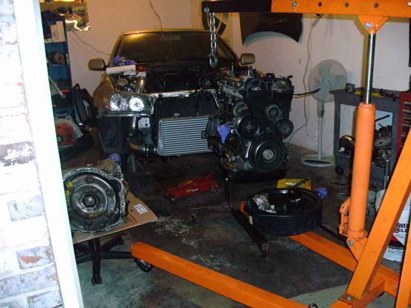

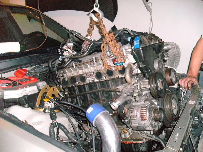

I have search everywhere for one. Can't find one, so I'm going to make one. I was able to boost my car with reading from the site. So I'm going to give back to the site to help others out. I boosted my car>
http://my.is/forums/f114/another-boosted-making-lots-pics-354985/
Old news. Well the motor had 109xxx on her, and he rings said no! So I'm doing this now. And when I have all the pieces I will show you step-by-step on how to build the 2JZ.
^thats me......HI

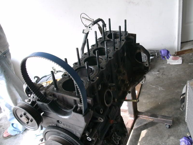

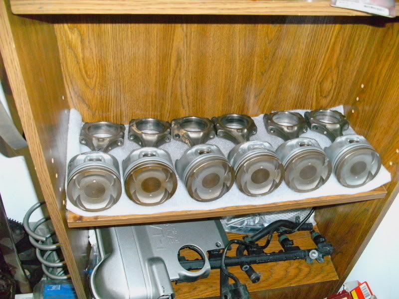

These are going in. GTE internals. Taking it apart was no problem, the trick is getting it all back together.:confused:
Rings.....not so good.

Make sure you measure out all your cylinder walls, check to bore size, scoring, and eccentricity.
Also check all your bearing clearance.

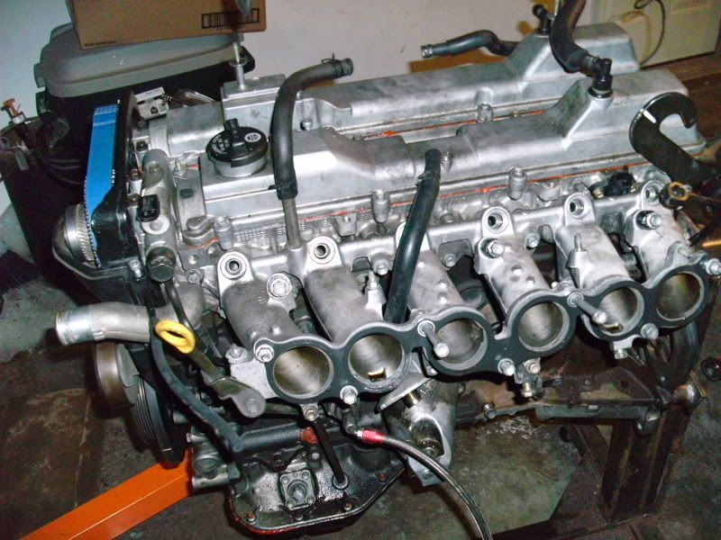

I also noticed that instead of spending 25 bucks on a valve cover gasket set you use some permatex stuff. Cutting corners like that kinda worry me a bit.
My best advice would be don't cut corners and make sure you do everything the right way the first time.

From the best of my knowledge the valve cover gasket is black in color. If you look at your picture there is red/orange permatex sealant pushing out along the perimeter of the vc.
If you are using standard GTE 86mm pistons, there are no other different size rings besides stand size rings.
Honestly, with work as intense as rebuilding a motor I would never recommend a DIY for such in dept work.

the oil pan gasket is Toyota FIPG or just any RTV that works with engine oil. i agree i dont think this is a good idea for most DIY'ers but its good information to read about.
