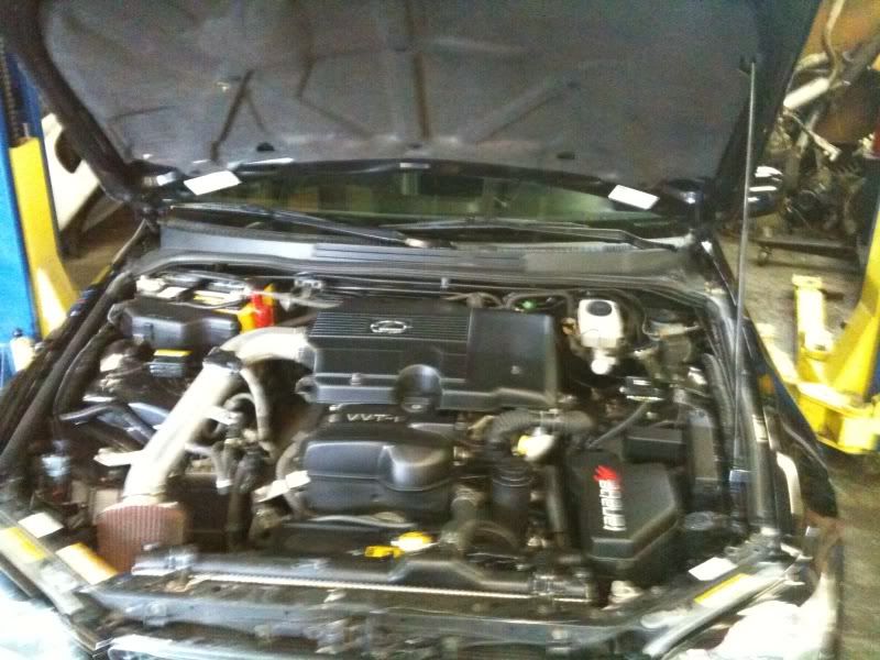

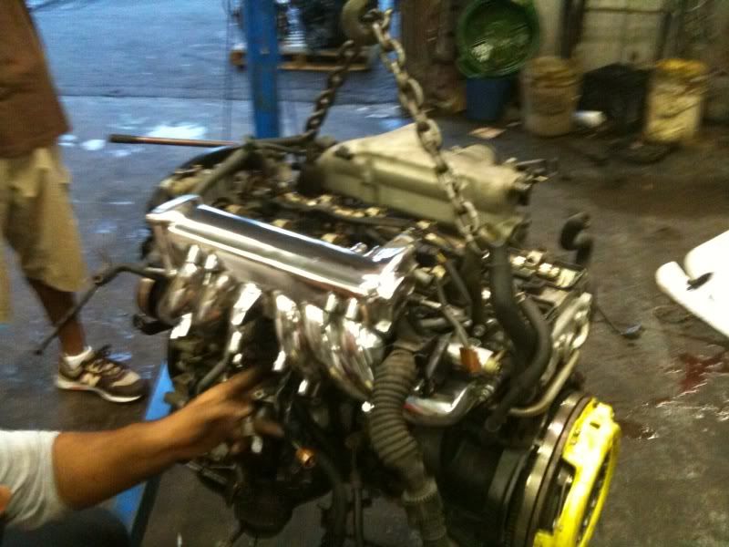

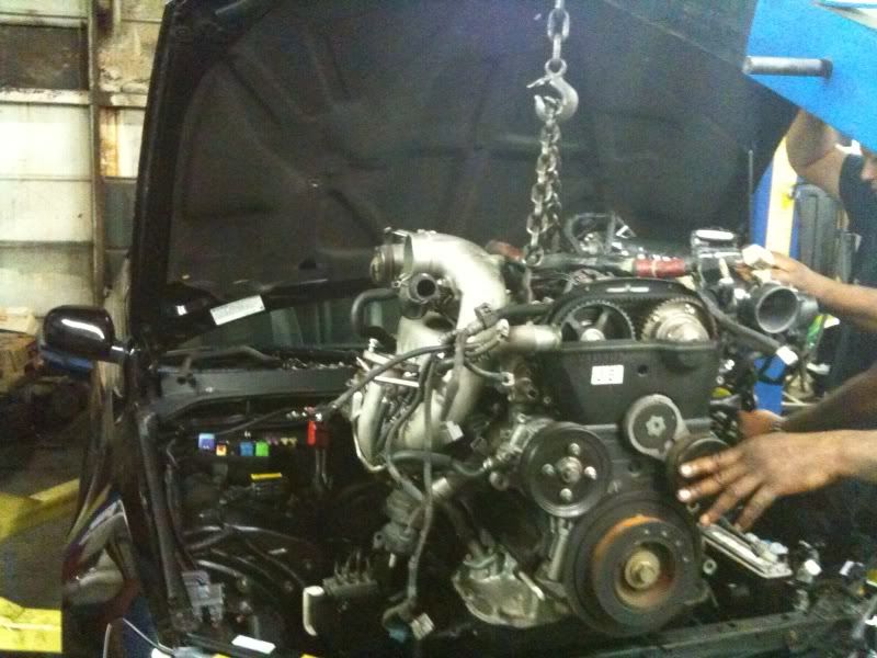

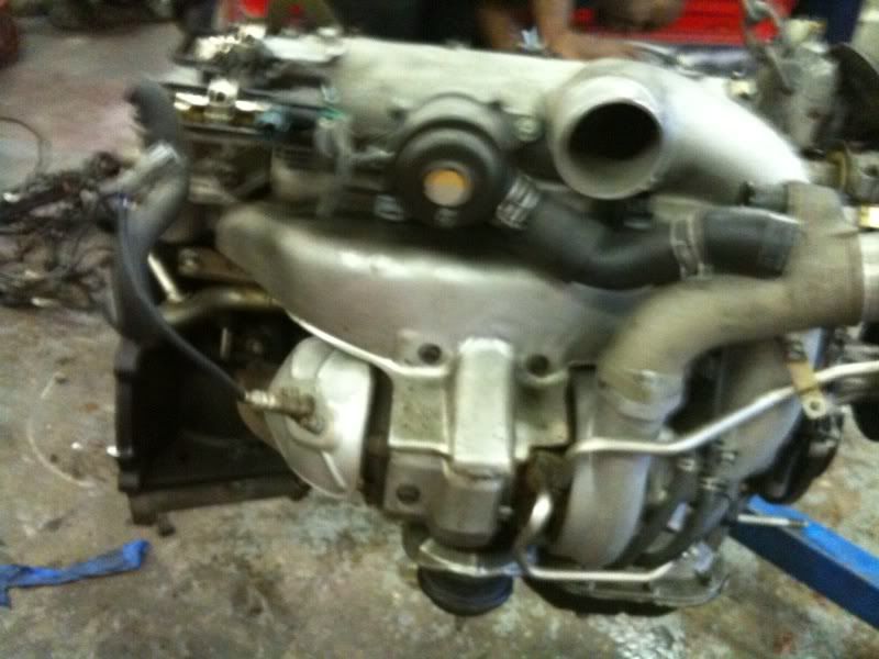

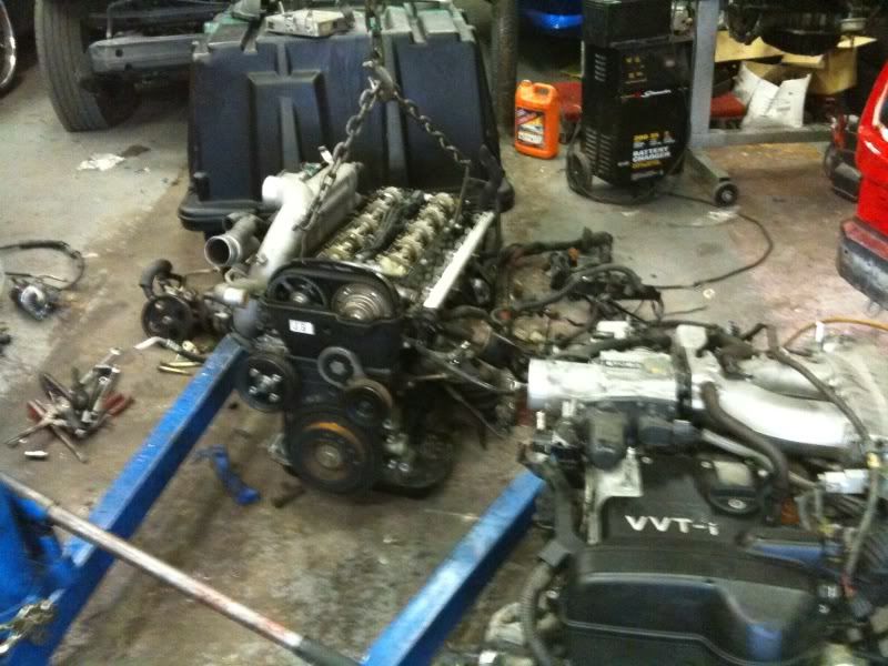

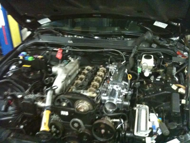

I started my swap last week tuesday, its gonna be a simple swap for now, everything stock on like 15psi or so. The swap is already finished, we are just wating on the wiring guy. Here are some pics ill try to get the rest tomorrow...
Feel free to ask any questions..

Are you going to stay with the w55 or upgrade it to something else?
yes w55 till it brakes lol

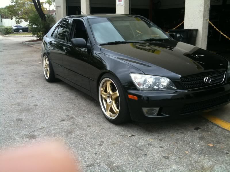

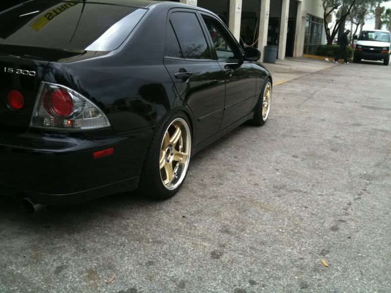

Did you need any spacers to clear the front wheels? It sounds like it's pretty close to inner upright.
its got a 5mm spacer

are motor mounts custom or can you use the oem ones?
very simple swap, nothing custom at all! Motor came off at 4 tuesday, by 6 the 1j was already in. It uses back ur 2j mounts, u just have to beat the oil pan a little to clear the crossmember
