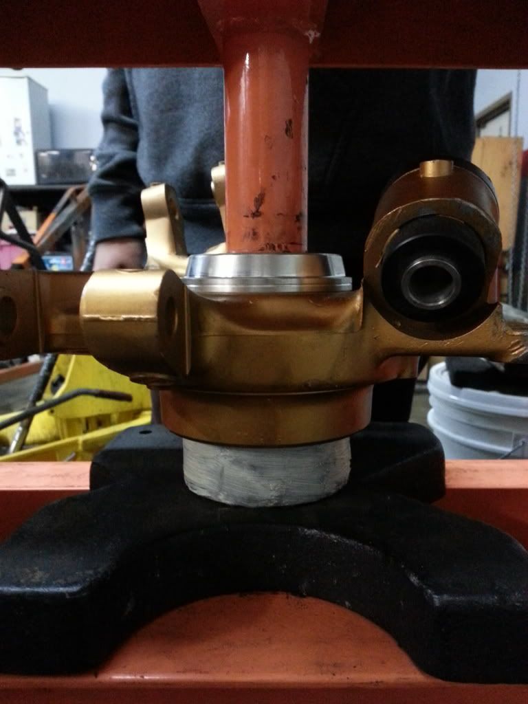

We did something baaaaaad...
Drilling out the trailing arms to accept our beefy links.

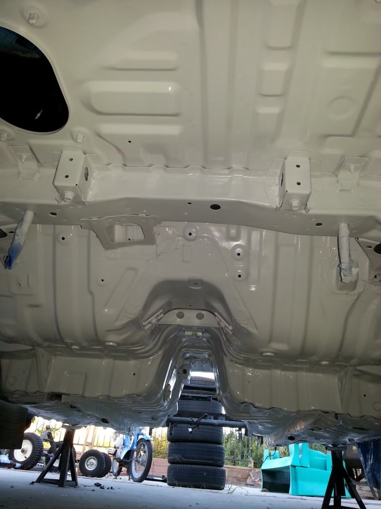

Finished off the sound deadening by scrubbing off the remainders with goof off, a drill and wire brush bit. You couldn't pay me to do this job again...

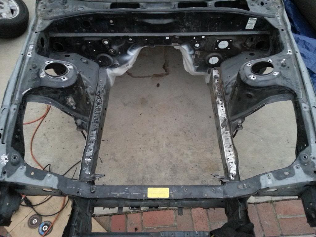

G U T T E D
AND it's finished. All our hardwork paid off in the end..

Now I know what you're all gonna think (all 4 of you), why would they paint the underside of the car? Well, I'll tell you now. Because we felt like it..Lots of degreasing, simple greening, pressure washing, and scrubbing followed by 6 cans of primer, a few days to dry and 8 cans of gloss white cause if it ain't white, then it ain't right. (i'm just kidding, i'm not a racist)
Unfortunately we began losing light before we could hit the inside of the car since it was all wire brushed/sanded down to bare metal for the most part. So we quickly sprayed it with primer for the time being.
