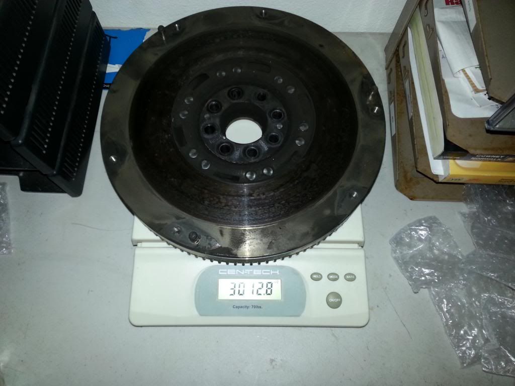

Clutchmasters FX100 clutch kit - just put this in the other night!
OEM flywheel

Installed this during the clutch swap - Between that and the single mass flywheel, finally feels like a real clutch!
