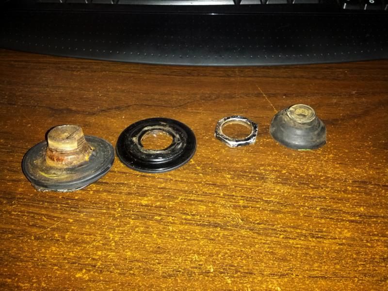

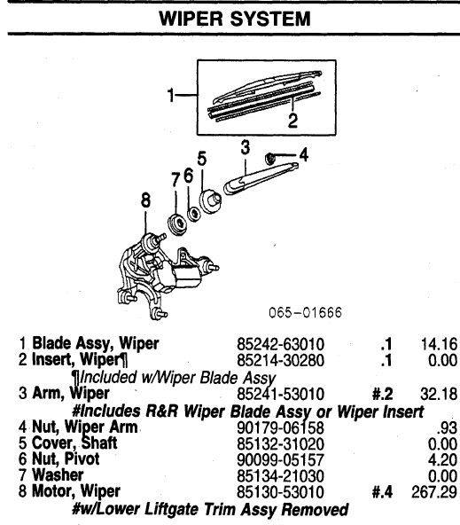

Mine finally crapped out after years of service...and neglect. Ordered all the parts below from Carson expecting everything to be fused together. (Yes, they were.)
Disassembly was of course the hardest part.
- Plenty of penetrating lube everywhere.
- Wiper will be really on there, so use a screwdriver with a wider head to pry off from the motor arm.
- Washer and nut (#6 & 7) was hopeless, ended breaking it up with a saw bit.
And the mangled nut from using an adjustable wrench. (Weird size, didn't have a wrench large enough.)
- Motor arm was in bad shape. Rubber ring disintegrated. (This was after a good wipe down.)
90179-06158 body hardware, lift gate, wiper & washer components, wiper arm nut 1 $0.00 $0.99 $0.99
85134-53010 body hardware, lift gate, wiper & washer components, motor washer 1 $0.00 $5.46 $5.46
90099-05157 body hardware, lift gate, wiper & washer components, motor nut 1 $0.00 $4.26 $4.26
85132-53010 body hardware, lift gate, wiper & washer components, cover 1 $0.00 $4.00 $4.00
85130-53010 electrical, chassis electrical, wipers, rear motor IS300 1 $0.00 $229.78 $229.78
Total: $244.49
Didn't think sold just the blade insert, but they do:
85214-53070 body hardware, lift gate, wiper & washer components, insert 1 $0.00 $4.49 $4.49
